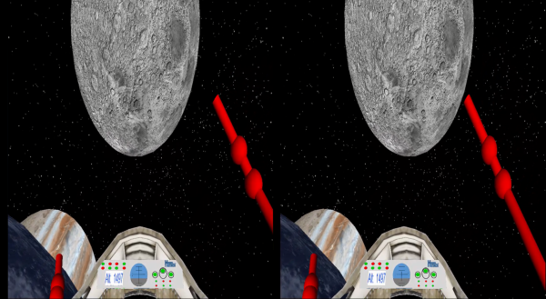

The spaceship application can be modified to compensate for this deformation by using the Model View Matrix available from one of the property nodes of a 3D Picture control in LabVIEW. The Model View Matrix of the 3D picture controls of each eye must be multiplied by a scaling matrix (affine transformation):
This operation results in the typical SBS image shown below for the spaceship application:
