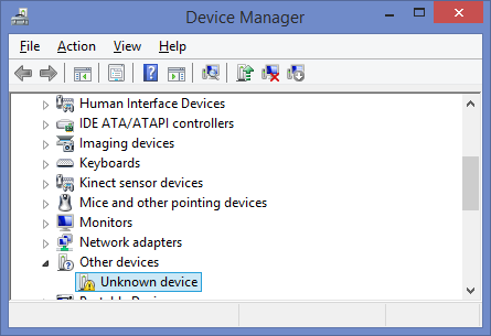

When plugging in the robot for the first time, you might be prompted by Windows to select the driver or you might have to go into the Device Manager and find Unknown Device (see image below).

After boot is complete, go to the device manager and right-click to select update driver.
Click  “Browse my computer for driver software”.
Click on “Browse” and select the directory where the owi_USB.inf is. Click Next.
The dialog shown below might pop-up. Select “Install this driver software anyway”.
Click Close. The OWI-535 robot should now show up in the Device Manager as shown below.

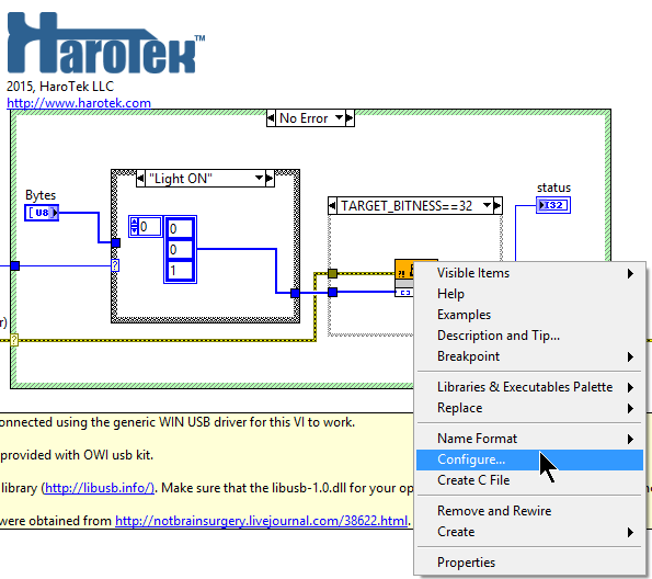

And how to run the vi ? the subvi's are not responding shows errors
Message 5 of 12
(22,091 Views)
Message 6 of 12
(22,091 Views)
Normally, if you just unzipped the package and open the VI from the as-is folder it should just work. The owi_control.vi should find the DLLs. In any case, if for whatever reason, the VI cannot find the DLLs, just open the owi_control.vi, go to the Call Library Function node corresponding to the bitness of your LabVIEW version (32 or 64, probably 32), right-click on it and select Configure (see below).
Then, select the Function tab, and navigate to the location of the DLL on your hard drive and select it. Make sure that you select the dll corresponding to your version of LabVIEW (likely to be the x32 DLL).
Also make sure that the libusb-1.0.dll is still in the same directory than the DLL (there are two libusb-1.0.dll, one for x32 and one for x64. They have the same name but they are not the same file). This is not your problem right now but it would be if you moved the files around.
As I said before, if you just leave the files and the folder structure as they were when unzipped, the VI should just work.

It works perfect now!
                                      Thank you!
