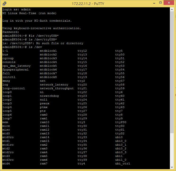

Hi fahad80
I used the USB devices called USB2DYNAMIXEL.The device is from ROBOTIS,I want to connet it between AX-12A motor and myRIO .
So I follow the steps from this link  https://decibel.ni.com/content/docs/DOC-34827   ,but in the step 1 I use the putty to login
myRIO and type the following commands #ls /dev/ttyUSB* but I cannot see anything about ttyUSB0.I was new to Linux and I tried my best
to search for something that could be help But it didn't work......
Can you give me some advices about this
Message 17 of 24

Hello roger_741,
We are actually in the process of updating our content to address this exact situation. The instructions that you were using pertain to 2013 (which uses mdev), and there have been some changes for 2014 (which uses udev). Please give these steps a try and let me know if it solves the problem:
1. Add the following lines of code to udef.conf in the folder /etc/udev
#typical devices
ttyUSB[0-9]* root:tty 666
2. Create a file named 99-ttyUSB.rules in the folder /etc/udev/rules.d
3. Add this line of code to that file:
KERNEL=="ttyUSB[0-9]*", OWNER="admin", MODE="0666"
3. Reboot the target. You should now see your USB device added to the myRIO in NI MAX.

Hello  Erin D,
Thanks for your reply.I tried to find the folder /etc/udev but i can't see it.
My LabVIEW version is 2013 and myRIO version is below,so did it mean that i could not find /etc/udev
Message 19 of 24
(8,563 Views)
Hello roger_741,
I apologize I assumed you were on 2014, the steps that I outlined before would not be relevent for 2013. There is a chance that the FTDI module is not being loaded automatically. If that is the case, please try the modprobe command outlined in the following article and let me know if that helps:
How Do I Detect if My USB Device is Recognized and Usable By the NI Linux Real-Time Operating System?
http://digital.ni.com/public.nsf/allkb/94A534CA79FF8A7E86257C670068ED2B
Erin D.
Message 20 of 24
(8,530 Views)
