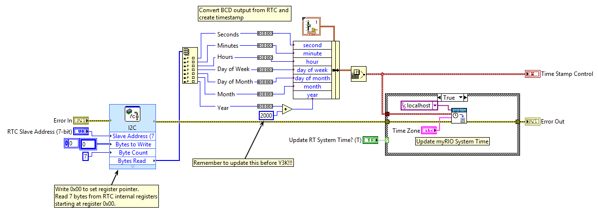

You have a couple options for doing this.  You could use a time server and SNTP to have your real-time target (myRIO in this case) connect to a time server at boot and update its clock.
More along the lines of what you're asking (I think) you can use the NI System Configuration API to update the time from LabVIEW.   I created an example that demonstrates how to use a battery powered  RTC (real time clock) to update the myRIO system time.  You can find the code attached.  Just ignore the RTC bit if you want to manually enter the current time.
Let us know if that helps or if you have more questions about this.

Hi Sam
I am trying to implement your solution, but it does not yield the expected results.
The wire with SECONDS, for example,  has values that rather than range from 0-59 goes up to 255, clearly indicating that there are problems with the conversion of the extracted from the chip. So does the other wires, with totally nonsense values.

Hi Sam,
I tried again, and now everything works. I was using the I2C READ MODE, but I have to use READ and WRITE MODE (as your example did) and this way works but I do not know why using I2C READ MODE does not work. Do you know why?

Hey,
If you just use the read mode then no data is written to the RTC.  Before you can read you need to send the correct command to tell the RTC that you are about to read.  Without it you won't get the right data back.
-Sam K
