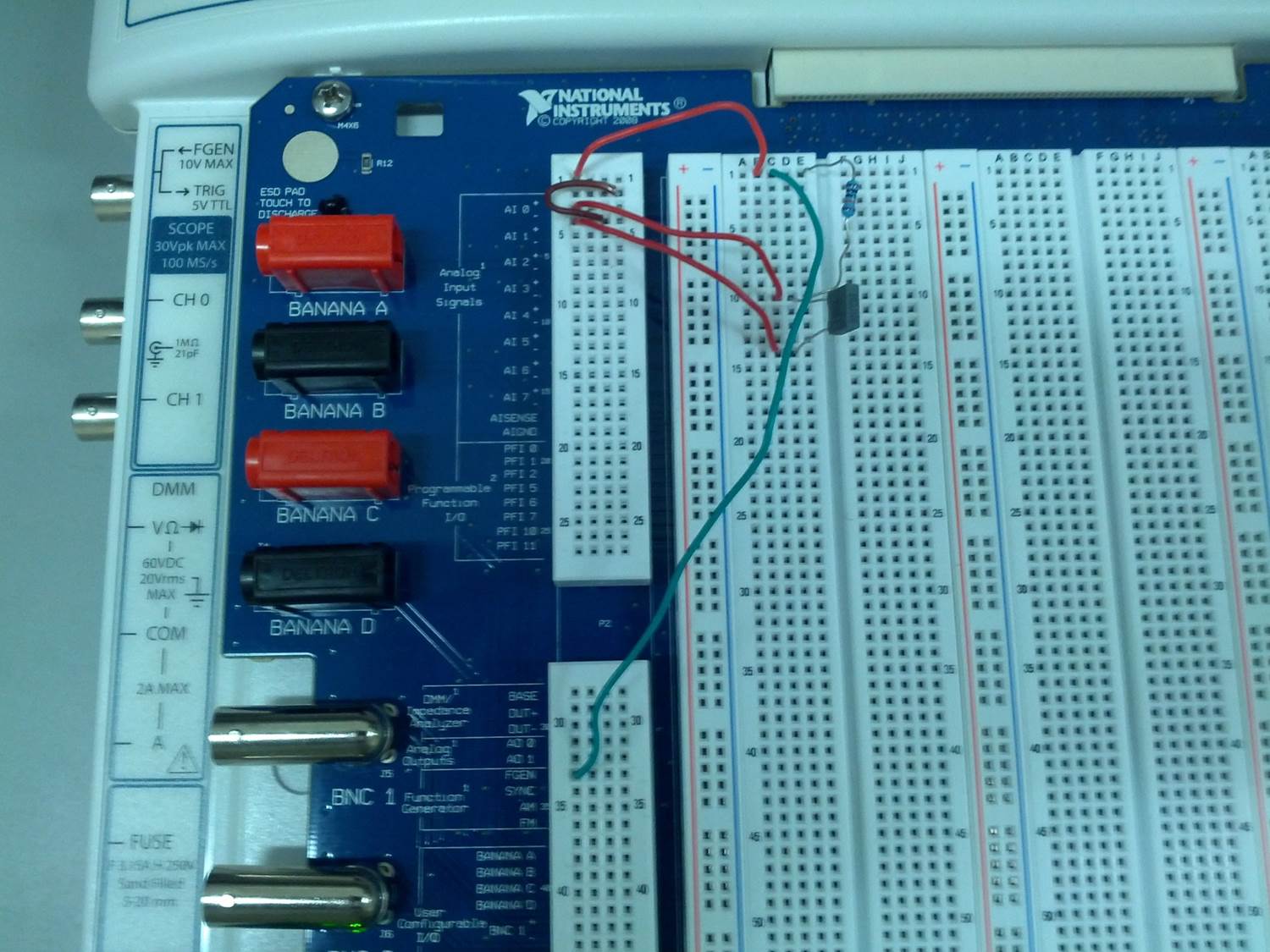

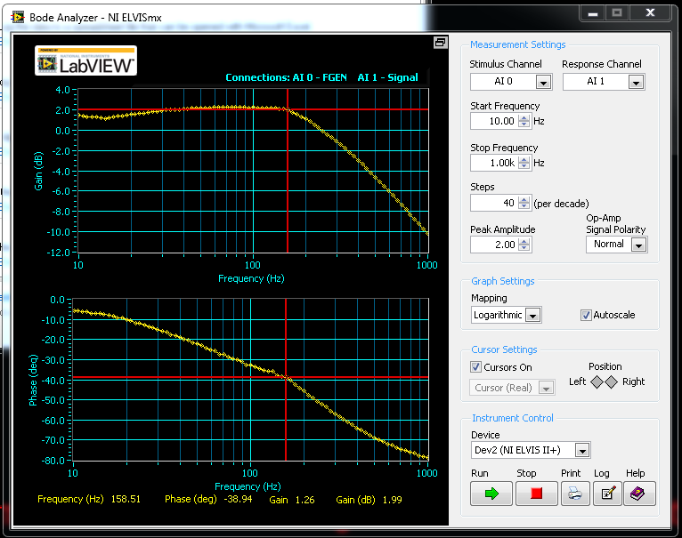

Here is a photo of the circuit connection without a separate ground (i.e., only using the AI channel +/-) and a capture of the Bode plot.  The gain plot is acceptable except that the actual gain at the corner frequency is not -3dB and it should also be 0 up to that point.  The phase plot is not very good.  I also tried connecting the negative side of the AI channels to ELVIS system ground.  That Bode plot is also attached.  It's much worse.
