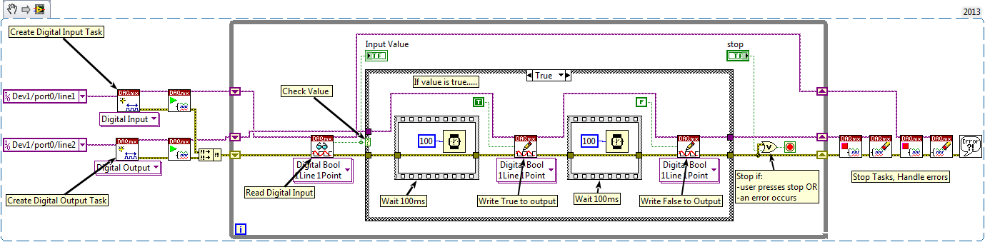

Well, this is how you can do it in LabVIEW!
