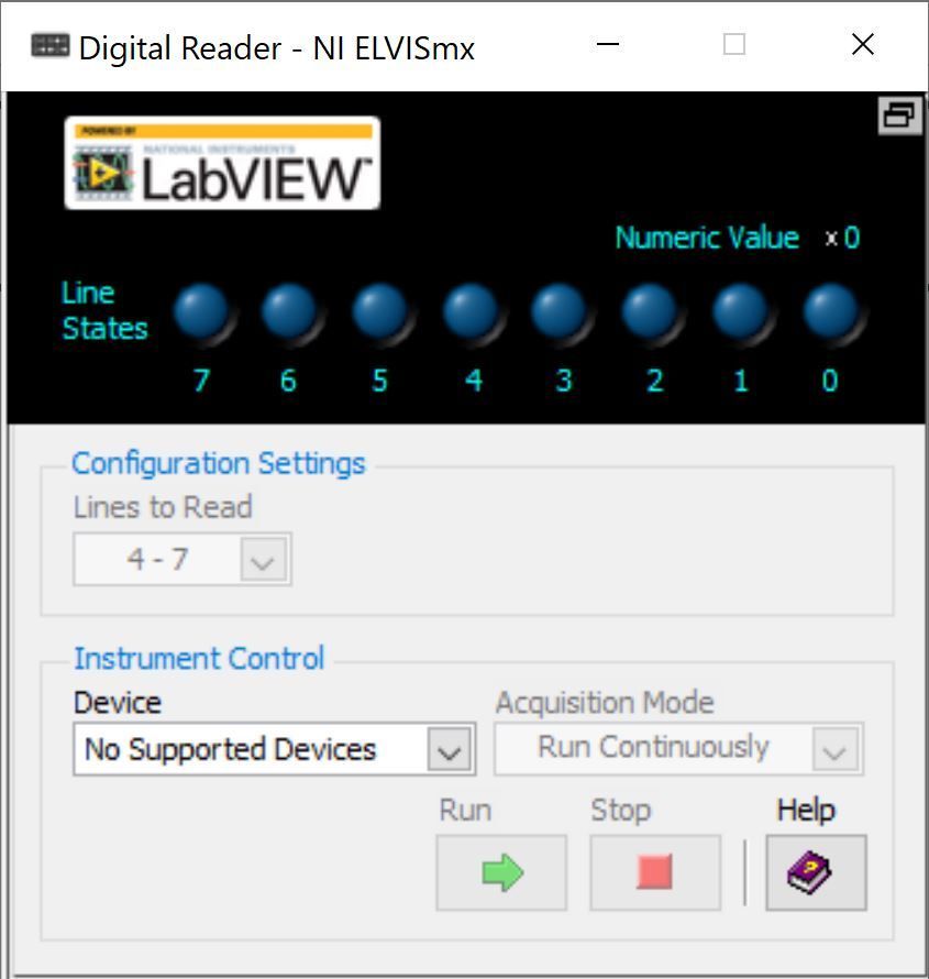

I have my MyDAQ connected to my computer but when I run any of my applications on the NIElvisMX Instrument Launcher it keeps saying there are no devices supported. I need this fixed ASAP so I can continue on with my project.Capture.JPG

A myDAQ is not an ELVIS.  Do you have MAX installed on your computer?  If you open MAX, and look under Devices and Interfaces, when your myDAQ is plugged in, it will show up in MAX.  [I just did this, myself ...].
