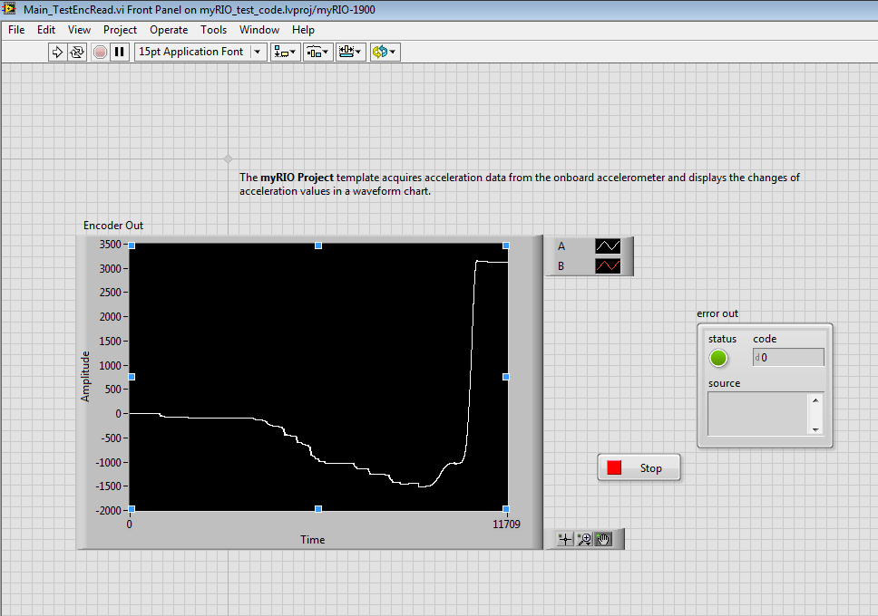

For completeness, here's my basic VI:
And here's the front panel: around time 9000, I moved the actuator forward, but from zero until then, all that drifting is from this undesired encoder behavior.

If you're encoder has about 30,000 ticks per inch were talking about 33 micro inches per tick.  The drift you're seeing is about 1500 ticks which is about .05 inches.  Is it possible the system is actually moving around this much?  Have you used this setup with another system reading the encoder values?
When you say the drift doesn't happen when the laser is off, do you mean the motor controlling the Laser or the beam?  Is it possible the beam causes vibration in the system?  Is the laser systems power tied to the myRIO power?  Its possible the laser causes the encoder power to become noise and generate bad pulse?

Thanks for your response - it's helpful in me seeing the bigger picture. I think it was actually a hardware issue. I was able to use another processing box that generates the encoder counts from the laser, and that worked without any drift.
