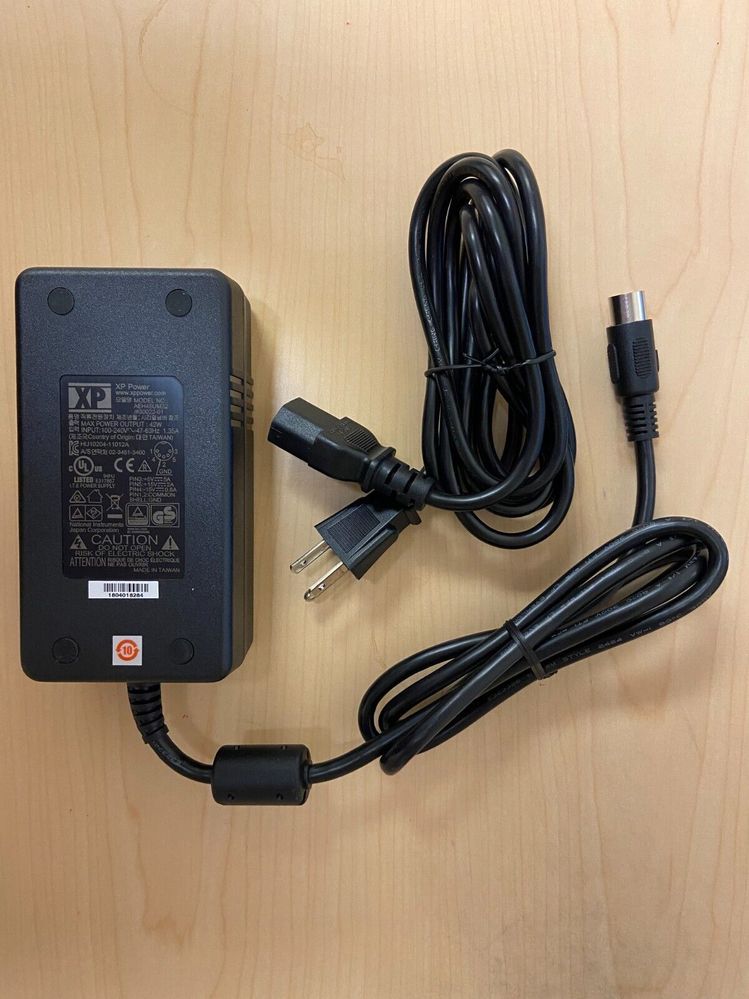

Can anyone take the picture of stock NI Elvis 2 power supply so I can see the specs?  Thank you very much

Looks like a lot of ebay listing show image of the power supply with specs.
This is one such - https://www.ebay.com/itm/125678474898
as per the above image, it is XP Power model: AEH45UM32,
Pin 1, 2 : Common
Pin 3 : +5V 5A
Pin 4 : -15V 0.8A
Pin 5 : +15V 2A
