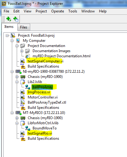

I have been trying unsuccessfully to send data between two VIs on two separate myRIOs using a shared variable. I created the library with the shared variable (ballPosArray) in the myRIO that writes data to it. I can get the data when using the variable in other VIs on the same myRIO or on VIs on the computer (testSignalComputer.vi). However, I can't read the data from the variable in VIs on the second myRIO (testSignalRio.vi). I tried accessing it by just dragging it to the Vi first. Then I tried creating a separate library and variable on the second myRIO and binding it to the original shared variable (PSP URL) but I get a 'process specified in the binding URL does not exist' error. I have gone through the threads containing similar issues, but can't seem to get it to work.

Firstly, I do get an error when trying to access from the second myRIO :
    Error -1950679023 occurred at Shared Variable in Rio2_Rio1Read.vi
    Possible reason(s):
    LabVIEW:  (Hex 0x8BBB0011) The process specified in the binding URL does not exist. Ensure that all shared variables are deployed and the variable identifier URL is correct.
I did deploy the libraries before running the VIs.
When hosting a variable on the second myRIO, I can read it from the computer and other VIs on that myRIO, but not on the first myRIO. Interestingly, when I try to bind a variable on the first RIO to one hosted on the second using PSP URL, the library and the variable on the second myRIO (the host) does not show up when I browse for variables. This is not the case when I am going the other way.
I am not sure what the difference in between binding to PSP URL vs Project variable, and I tried the latter as well. I can access the second myRIO variable from the first if I select project variable when binding, but I get the same error as earlier.
Hope this is not too confusing.
Sanjid
(6,163 Views)
