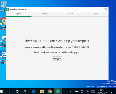

I've tried to install NI-DAQmx on Windows 10 32 bit, but it doesn't work, is it possible to install NI-DAQmx on Windows 10 32 bit?, how do I do that?

you can use offline installer if you're having issues with the online one.

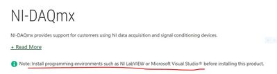

Have you installed LabVIEW or Visual Studio before installing DAQmx driver?
It will work if you have already installed either one of the software because DAQmx is a driver and it is using in these softwares.
Also, if the installation doesnt work, you might want to remove the driver using NIPM and try to reinstalling using online or offline installer. Usually it will work.
