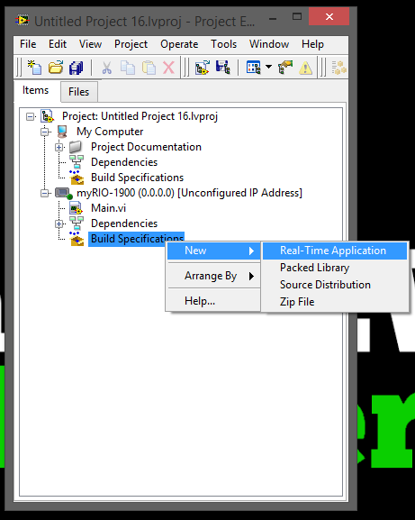

is this in refrence to the following real time:
  1. Open the project you want to use to build the stand-alone real-time application.
  2. Right-click Build Specifications under the RT target and select New»Real-Time Application from the shortcut menu to display the Real-Time Application Properties dialog box.
  3. Complete the following items on the Information page of the Real-Time Application Properties dialog box.
(7,292 Views)

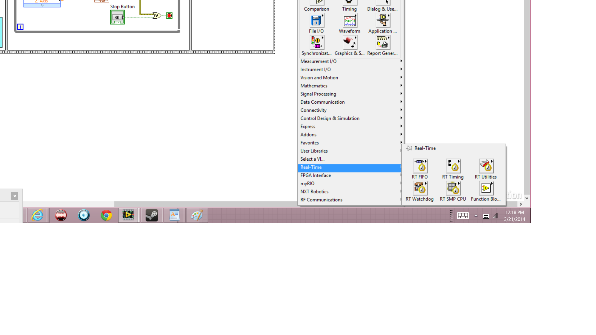

Is that the real time application they are talking about?
(7,291 Views)

That document is referring to the LabVIEW Project.  When the myRIO target is added to the LabIVEW project there is a Build Specifications section under the myRIO target.  You can right click that and add a new Real-Time Application (exe).

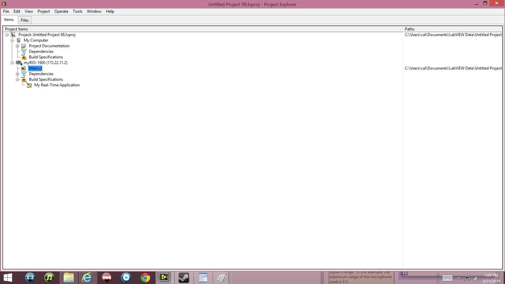

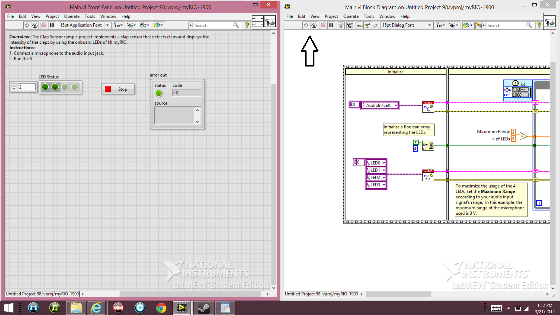

Ok two comments/questions:
1.  So I hit run on this it's stored on the myrio correct?  Read for power to come in and out to real time it.
2.  How do I delete this off the myrio then?
Since it's stored on the rio,for everytime power is connected, how do I take this file off?
Also two quick snapshots of my actions:
