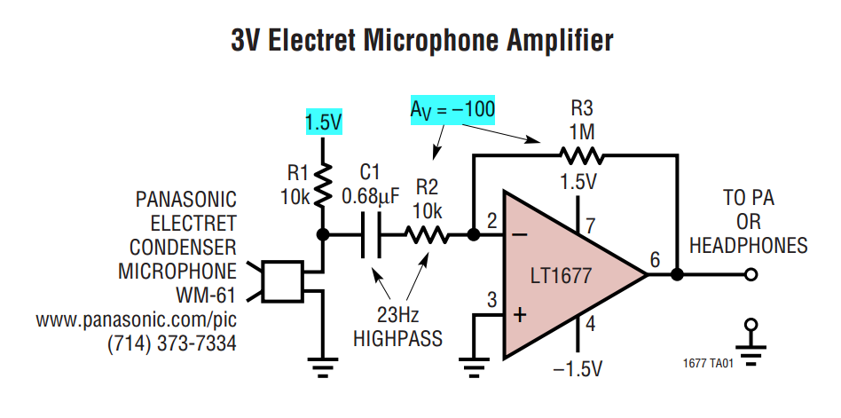

Due to some reasons, i changed the microphone with an amplifier and when measured using oscilloscope and other DAQ devices, the output range from +5V to - 5V.

Single ended output from micorphone and/or amplifier has 2 pins: Vout and GND
Different input has 3 pins: A+, A- and AGND
I had attached the screenshot of the OPAMP data sheet for your reference
