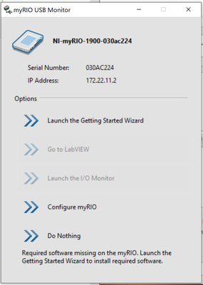

Hi all,
I am having issues getting my myRIO to be recognized by LabVIEW and/or my computer. I have attached screenshots of several things to show what my issue has become. I have un/re-installed all software related to LabVIEW (student here), reset the device itself, and nothing has worked. As a last resort, I have un-installed everything again, and went further into regedit to remove all files in the registry associated with NI to perform a clean install. After the clean install (LabVIEW and myRIO toolkit), I cannot find the LabVIEW icon for the myRIO, which is odd. However, even after this clean install, the problem persists with the network driver, and the myRIO makes a USB recognition sound when connected to the computer, but the device doesn't show up anywhere except the attached screenshot from NI MAX. This happened after a Windows update, although when looking through the log the only two updates were Silverlight (flag) and Adobe. However, such update is listed in the install file of NI LabVIEW, as it makes me agree to both Silverlight 5, and 5.1 (with the latter being the update). I tend to pause updates, although recently I was forced by Windows to perform them.
I also downloaded the USBLAN driver, and I had an error (seen in the screenshot uploaded if I didn't forget). I have contacted my professor to see how they may approach this situation, and also tech support; being a student they were no help due to "institution agreements". Not flagging them for it, as I understand, but perhaps their license could blatantly state that instead of telling me to contact them in their troubleshooter. I have an assignment and lab due on Sunday, which I would love to not be late for, but I think the professor would understand if that were to be the case, or I hope (laughs). Any help would be appreciated, truly. Thanks in advance.

Dear Bob
I have the almost same problem as Rafco.
After I uninstall all National Instruments softwares, modules, toolkits, etc including "Program File(x86)\National Instruments" folder and their registries. I succedded to install LV2016 myRIO bundle. However, the myRIO cannot communicate.
After plug in, there was a warning "Required Software missing on the myRIO" and I "launch the getting stated wizard" with no success and displayed error message as "Cannot communicate with NI-myRIO-1900-030ac224". The 30ac224 is the myRIO serial number.
Continued to run NI MAX and did the system in Safe-Mode, after pressing reset button and restart the system. It could not be detected., with No "Hostname", No "IP Address", No "Product name" and No "Serial Number"
Again it went to pop-up windows as if I plug-in the myRIO with the same error message. Launching  getting started with the same error message: "Cannot communicate with NI-myRIO-1900-030ac224"

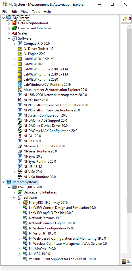

P.S. -- I'm going to try to attach a screen shot of one of my PCs with LabVIEW 2019 SP1 (32-bit) and LabVIEW 2020 (32-bit) installed, along with the myRIO Toolkit (which, you might notice, does not appear under My System, but does appear under Remote Systems, associated with my attached myRIO).  I've probably put a few more things than you would need, but it is largely what I described above.  Let's see if it fits ...

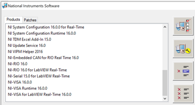

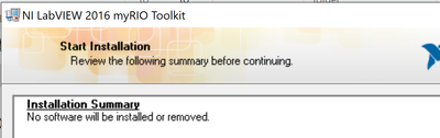

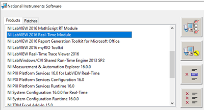

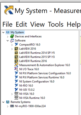

It is true that I removed all the NI software, because every time I reinstalled myRIO bundle, it skipped installing LV2016. Therefore I removed all the folder in the "Program Files (x86)\National Instruments" which I assumed as a clean installation. Anyway I can install LV2016 myRIO bundles, as shown in Figure:
According to MAX, the software that I have installed are:
 It seems that the LabVIEW Realtime and myRIO Toolkit did not correctly installed. When I reinstalled myRIO Bundles, it cannot be installed, as shown below:
However, when using "Setting >> AppS & features >> National Instruments Softwares", it seems that the Realtime module and myRIO had been installed

Hello, Sastra.
It appears that you are, indeed, installing LabVIEW 2016, which pre-dates NIPM, which means you do not need (and probably should not install) NIPM.  Trust me, it is much easier without it, and if you continue to use (and upgrade) LabVIEW, you will eventually be forced to use it.
When I look at the Software listing that MAX sees, I don't see LabVIEW Real-Time, yet some other setting shows it.  This suggests (to me) that you might have a bad installation.
If I were doing this, myself, or if you were one of my students and brought your laptop to me with this problem, I'd proceed as follows:
  • I'd assume that the previous installation was faulty, and would recommend that you do a "Safe" Uninstallation of all NI Software.
  • I'd then suggest that you do a reinstallation of LabVIEW 2016, followed by the myRIO 2016 Sofware Toolkit.

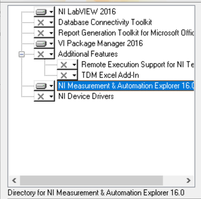

As you suggest I did not use NIPM, and installed each software at a time followed by booting.
1. Install LV2016 with NI MAX (this part has to be installed with LV2016). Other part can be disabled
This step installation I included VIPM2016

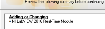

2. Install Real-Time Module only

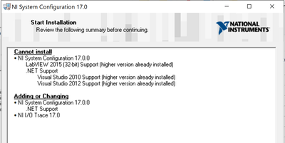

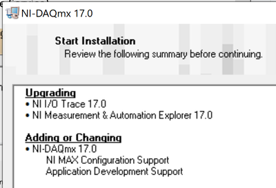

3. Install Drivers
a. I installed DAQmx 17.0

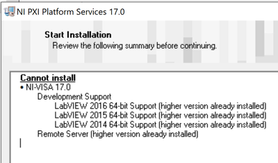

b. NI VISA version 17 could not be installed, as it already installed higher version. I never intentionally installed NI VISA driver.
I did not installed NI VISA driver
c. System Configuration
4. Install myRIO Toolkit did not have any problem.

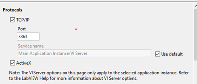

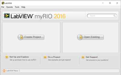

After booting I made some changes in LabVIEW options as you suggested
Message 9 of 18
(13,027 Views)

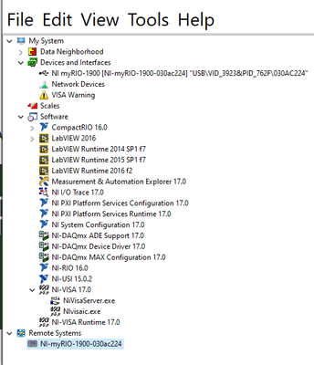

It seems that it has been cut of my respond.
After plug in myRIO, I got the same error as previously
From the NI MAX, I got this:

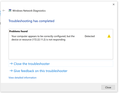

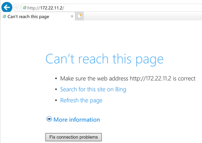

I could not go "configure myRIO" using Internet Explorer. It seems that IE couldnot detect the myRIO firmware, as shown:
Is there any mistakes of my installation? Looking forward your suggestion. Thank you
Sastra Kusuma Wijaya
