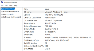

Thank you for suggestion to do reinstalling windows.  I am struggling to do clean install of Windows. After downloading windows10 from microsoft, and put into a bootable usb (using rufus 3.13). Change the order of booting, and boot the laptop. Nothing happens. It read the usb flash disk, as it was blinking and I wait for a quite long time (maybe more than 20 mins).
Before doing that I did "Reset this PC" from "Windows >> Setting >> Update & Security >> Recovery >> Reset this PC", by applying  "Keep my Files" and later on by applying "Remove Everything".
I could not find "Disable Secure boot", as my laptop does not support "UEFI settings", as there is no option of this setting, as shown (after struggling and found instruction using "msinfo32" using command prompt )
As shown that my BIOS Mode is Legacy. It is strange that this laptop is legacy. I bought this laptop for 2 or 3 years ago

I am not too familiar with laptops, but Legacy vs UEFI doesn't have much impact on Windows installation as far as I am concerned, it's more for compatibility. I have no experience with rufus, as I only use WindowsMediaCreationTool for OS builds. Perhaps that may be why it doesn't boot from it? I don't think it will allow you to do a clean install from within the OS, as it needs to re-write to the disk being used; may force you to boot into it with a restart more than likely.
Download the WMCT from Microsoft and attempt to do the OS build that way. Keeping your files will not help much, unless I misread and Bob or someone else recommended it. You will need to back up all those files to an external device (if available) or any cloud service, as doing a "clean install" means deleting everything, and starting from scratch (as if you just purchased the laptop from the store today).

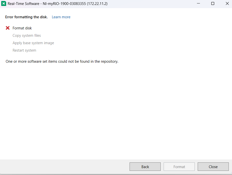

Hey, Bob I followed all of your steps but I am still getting this error message while installing software in NI myRIOScreenshot 2024-03-01 011447.png
