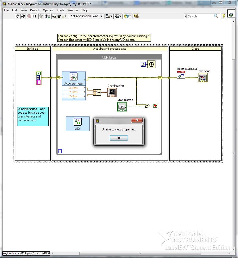

When trying to see properties of myRIO onboard utility VI's I get the error : "unable to view properties". (See screenshot). Without acces to the properties it is impossible to work with the myRIO. The properties of other blocks (non-myRIO VI's) can be opened without problems.

Hey Paul,
Do you get that error message when you place an express VI from the myRIO palette?
What happens when you place a VI from the myRIO>>Advanced IO palette?
Does the example code work (ie can you run the code in the screen shot above on myRIO successfully).

- Yes I get the error message when I place a express VI it from the myRIO palette.
- When I open a VI from the myRIO>>Advanced IO palette it seems to work normally, I can access its features.
- The example code does work, ie I can run it and it without errors and it plots the accelerometer data.
- Also I do use a uncommon installation path. I have it installed on a different hdd than my OS (which is indeed windows on both my home and university computer).
Thank you for your effort,
Paul.
PS. the project is just the standard myRIO project you get when you start a new myRIO project from the project explorer. I only added the LED VI to see whether it would give the same error and it did.
