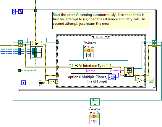

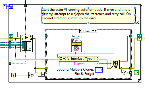

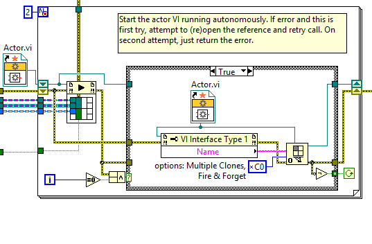

Hey Mike_Le we came across this as well and I think we're on the same page as you
I'd like to expand on this and we how we've dealt with this at Prolucid
Here's the original case
you can see the link on the unintiialized shift registers that Mike_Le is talking about
Above we can see an initialize on the shift register that solves the locking library problems. This was the fix we've gone with. The crappy side is it's super slow.
Now in 2014 (haven't confirmed back to 2013, would love to hear feedback from someone who is experiencing this probleim in 2013)
This solves the locking library issue and the performance issue.
If anyone is repro'ing the issue in 2013: the second last image will fix your problem. But please give the last image a shot and report back if it fixes it as well as it will provide a substantial perf improvement
weird benchmark details
2nd last image 1500 actors : 35 seconds
last image 1500 actors same system: ~5 seconds
