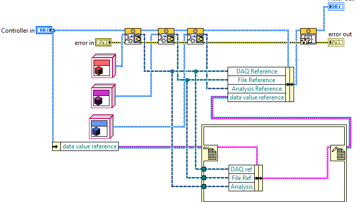

If I go this way, my normal controller would start Model A, Model B and Model C, but then the child could do extra stuff. I.e. when the controller recieves a Data message it can foward it to however makes sense (i.e. filelogging) but then the child can extend this and also update a graph. My original though was that this was a much neater way to do it, though while trying it out I found out that the child did not have access to the data in the actor core of the Controller class.
The only reason why I got this to work and can get the reference to ModelA is because I've also made those references available through a DVR in the controller class. So the method that gives me ModelA's reference is getting it from the DVR.
I'm not really sure if I like this or not. It simplifies things a lot but could also give some problems.

If I inherit from the controller that issue is resolved because the GUI then have access to the data of the controller including the references of the children. But actually it doesn't because those are instanciated in parallel to the GUI which means they have to be in a DVR for the child to access them. But if you put them inside of the DVR you save a lot of duplicated messages / forward logic. But I don't really like the DVR's that much for making the data available globally.
Never do this.  Ever.  There is no need to use a DVR to communicate within an actor, and it will buy you all kinds of trouble.  Your UI actor core will have a loop that handles user events and front panel updates - typically an event structure, as shown in your second post.  (We refer to these additional loops as helper loops.)  Use messages to pass data from your helper loop to the UI's message handling loop, which can then pass it on to your model actor.  Yes, this means you are duplicating messages, but this actually gives you more modular code.  If you'd rather avoid this, have the Model launch the UI, in which case you will have access to the Model's enqueuer when the UI's Actor Core starts, and you can send messages directly.
