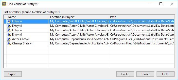

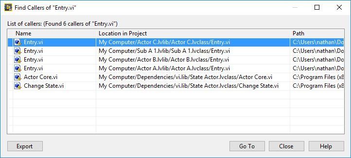

So two of the largest actors in the project somehow have a dependency on each other through the State Actor's "Entry.vi".  When I right-click on Actor A's "Entry.vi", and select show Callers, in the list, it shows "Actor B.lvclass/Entry.vi".  If I look in Actor B's "Entry.vi", it has the same issue with Actor A.

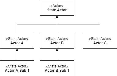

I've attached an example project that illustrates the problem.  I also noticed that the inter-dependency didn't occur until AFTER I created a child of Actor A and an "Entry.vi" for it.  (ie Actor A Sub 1)  For example, I created Actor C, and no children of Actor C, and it doesn't include Actor A or B's Entry.vi's as callers.

Actor A Callers
Actor B Callers

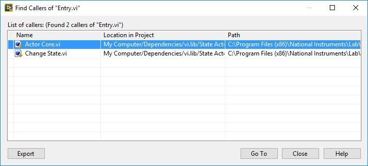

Actor C Callers
Actor Hierarchy
