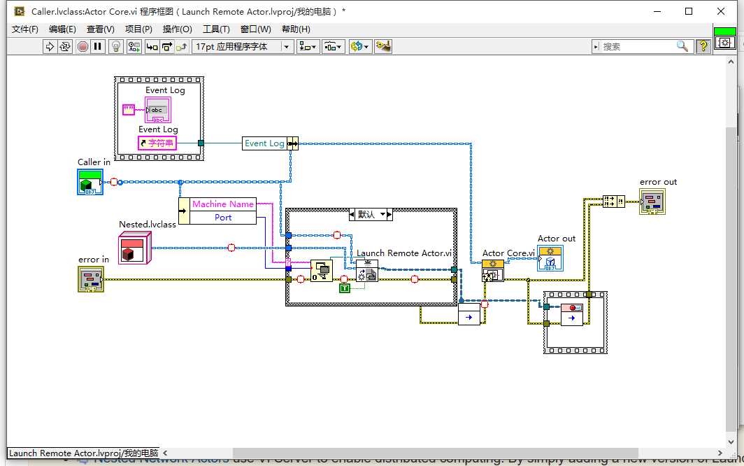

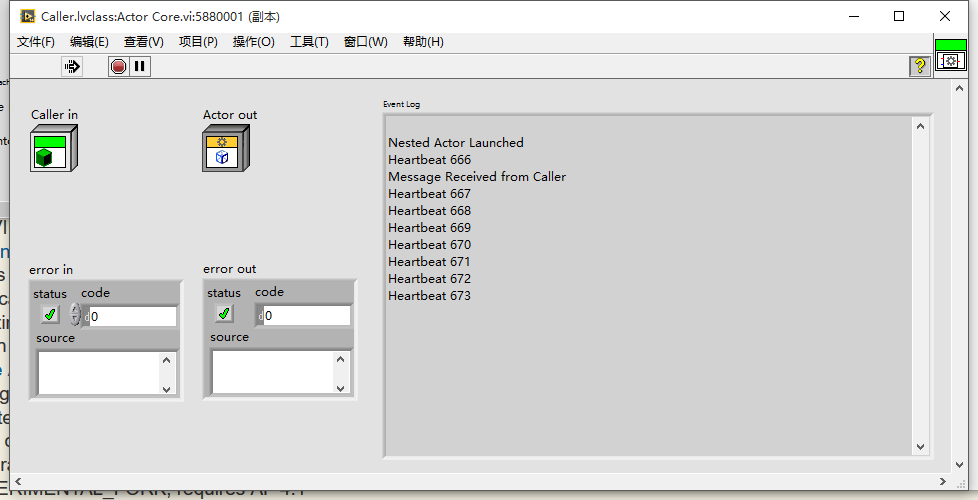

Hello AQ, niACS and everyone who is interested in this nice tool! I really enjoy programming with actor framework and finally I downloaded this vipc 1.0.0.15 in my LabVIEW 2014(with the default AF version 4.1 rather than the Experiement Fork shown above).Then I have to modify the Demo App provided by you with AF 4.3 because of the changes in Launch Actor.vi in LabVIEW 2014, and I've run up with many problems.

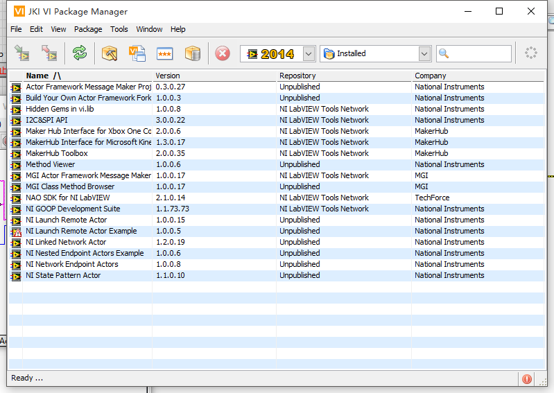

1,First of all, I will provide you with my basic information of the OS and softerware.The OS is windows 10 pro 64-bit, the LabVIEW's version is 14.0f1-32bit, and the add-on list is in follow:

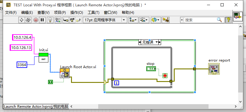

2,Now this example demo app is in my windows explorer and I need to modify some of VIs before it performs normally with AF 4.1 in LV 2014(Note that in AF 2014 the Launch Actor.vi has been replaced by 2 separate VIs, Launch Root Actor.vi and Launch Nested Actor.vi). So I modified 2 VIs, TEST Local With Proxy.vi and Caller.lvclass::Actor Core.vi in the demo app, which is something like follow. The demo app performed normally in 2 computers(while I changed some variables).

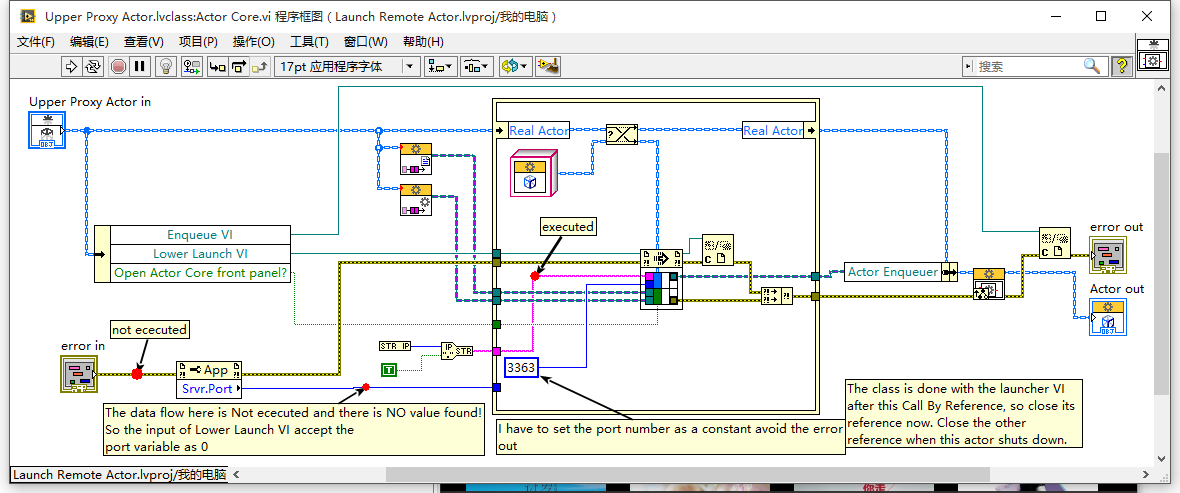

3,The problems started when I tried to cover the files in LV project. I tried my effort to find where the error is then I found it’s in Upper Proxy Actor.lvclass::Actor Core. The data flow from the app property node is not executed and there is NO value found thus making the Lower Launch VI to accept the actual parameter of port variable as 0! I have to set the port number as a constant to avoid the error out. I could not do that in my daily practices, so could anybody tell me what is going on and how to solve the problem?

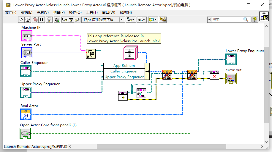

5,There may also be something to do with the Lower Proxy Actor.lvclass because the Launch Lower Proxy Actor.vi is not compatible with the new version AF 2014. Please see below. But please note that, if I do not use the LV project to launch this demo app, the app will work normally without modifying this vi.

So, two things:
1)  You should not have to change any code.  The package is intended to work with the version of AF that ships with LabVIEW 2014.  If the package code is broken, then you need to revert your AF to the version that ships with LabVIEW 2014.
Launch Actor.vi did get deprecated in 2014, but it is still available.  We did not change the example for this release, because Launch Actor still works.
In your own code, you can use Launch Root Actor.vi and Launch Nested Actor.vi with no difficulties.  I do see that you were able to do this with the example code.
2)  The example code does NOT work when run from a project, for reasons that are not clear to me, other than it is some kind of outside context problem (or, more likely, an inside context problem - some resource is being contested by multiple processes within a single LabVIEW instance).  I have used this package successfully in code that runs from a project, so the .lvproj file is not a barrier to actual use.  My recommendation is that you set up a virtual machine, or an actual machine, to serve as your remote while you build and test your application.
Since you know the demo works when you run it outside of a project, try building out the portion of your application that does remote management.  If you still have problems, let us know.
