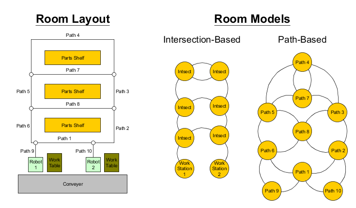

Defining empty space as a resource is a little different than defining a DAQ channel as a resource.  Space is continuous; DAQ channels are discrete.  In my (limited) experience with mobile industrial robot systems the robots are not allowed to take an arbitrary path to their destination. They must follow a network of predefined paths.  The helps simplify things a little bit--a continuous 2d resource (floor space) is reduced to a continuous 1d resource (floor space in the direction of travel.)
Maybe the space each actor is responsible for is equal to robot's footprint. Maybe it's a floor tile. Maybe it's arbitrarily sized according to the situation. For example, if there's a 10' path between two storage shelves that is only wide enough to accomodate one robot, that might be considered a single unit of space and be managed by a single actor.
A side question is how are you going to model the system? Do you want to model the connections (intersection-based) or the space between the connections (path-based)? On paper the intersection-based model is more intuitive, but since we're concerned with the space between the intersections and not the intersections themselves I think the path-based model is the better choice.
Thinking about this a bit I'm not sure there's a significant difference in functionality between having each path managed by its own actor and having a central actor managing the paths.  If anything the central actor is probably better componentized, easier to understand, and scales better.
The more I consider it the more I don't like the idea of individual actors managing an arbitrary section of floor space in this kind of situation.  If your units of space are too small you'll run into inefficiencies. A robot might get most of the way to its destination only to find the path blocked, then have to turn around and go a different route. If the units of space are too large (and that resource cannot be subdivided; it's either "available" or "not available.") you'll have inefficiencies from unused space.  The paths are subdivisions of the same shared resource, not individual resources in themselves.

I believe this is probably the simplest strategy to understand and implement.  It can work (I think) for any kind of resource.  For these reasons I think it's a good starting point.  In certain situations where the resource usage rate is high or otherwise constrained it may be very inefficient.  For example, if robot 1 is on path 3 and reserves paths 2 and 1 to return to its workstation, robot 2 is stuck waiting for a path to open up, even though they are not blocked at the moment.  Still, I think it would be relatively straightforward to refactor this strategy into a more capable strategy if the need arises.
2. Active Management / Resource Allocation / Progressive Reservation
Using the robot situation from the previous combination, robot 1 moves towards the intersection of paths 2 and 3.  Once there, it requests the path 2 resource.  If granted, it will progress down path 2 and release path 3 when it is no longer occupying that space.  The process is repeated at the intersection of paths 1 and 2, and again at paths 1 and 9.  This strategy allows robot 2 to exit at any time other than the brief period when robot 1 is crossing the intersection of paths 1 and 2.  Less time is spent waiting and efficiency improves.
On the other hand, this strategy ignores the overall goal of each progressive reservation.  It's easy to imagine deadlocks and various other blocking situations that don't have obvious general solutions.  Who should yield when n robots converge on an n-way intersection if you want to maximize efficiency?  There's no easy answer.  Rolling random numbers for priority can help resolve deadlocks, but it won't maximize efficiency.
