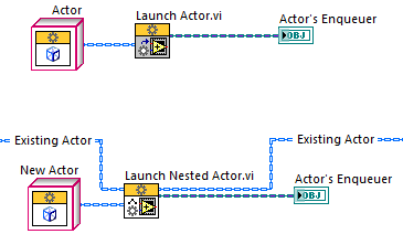

    I made a quick mockup to help see if there are obvious hidden issues here. I think that this shows quite nicely how this would simply circumvent all the problems people were having here. Here are the two new VIs:
    The names and setup are obviously open to changes, but this simplifies the entire system into a couple of simple rules:
    1. When an actor is launched it creats an enqueuer so that it can be talked to.
    2. If A launches B as a nested actor, then B has implicit access to A's enqueuer as its caller.
    I think this simplification is valuable enough that it's worth delving into to see whether it can actually be done, what all the problems with it are, whether they can be addressed, are they preferable to the problems with the existing system, can the various use cases be handled, etc.
    Also, note that the existing actor in the second image isn't modified at all by the launch nested actor VI, so technically it doesn't have to come out of it (and there are good arguments for not having it as an output. In fact, I think I would prefer not having it).
