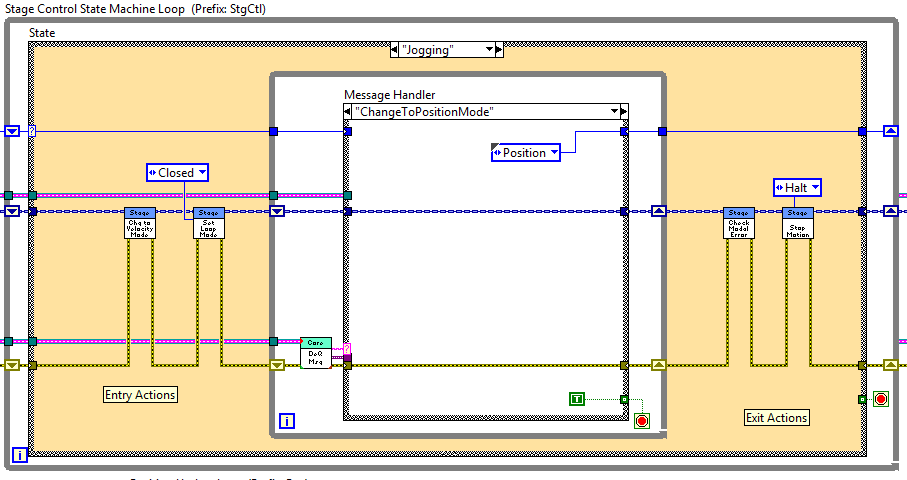

Daklu wrote:
The AF doesn't--as far as I know--support implementing a state machine directly in the message handling loop very well.
I'm missing something. The AF is a state machine as far as I can tell. As messages arrives, the actor transitions to different states and responds differently based on the current values of the fields. That can be implemented either as fields within the actor or by trading out the actor using the State Pattern. What are you thinking is missing?
Message 19 of 21
(2,566 Views)
I don't think anything is missing (except perhaps simplicity.)  When I said the AF doesn't support implementing a state machine directly in the MHL, I was thinking of the way I often implement state machines in the message handler:
There's a message handling loop, and the entire state machine implementation is right there.  That's what I meant by "directly."
In the AF the MHL is implemented in Actor.ActorCore.  Child classes can override it, but since they are required to invoke the base class method they cannot replace the MHL implementation with their own to do something similar to what I do.  It is certainly possible to implement state machines using the AF--I did not mean to imply otherwise--but it requires more indirection and it is (imo) harder to create a mental model of the state machine by reading the code.
Message 20 of 21
