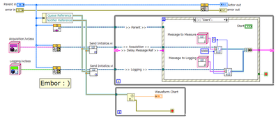

Dear Stefan, Eric,
I really appreciate your kind advice! I added TD message and it worked what I expected.
I stopped the measurement by releasing notifier reference on Stop case.
Cont Actor Framework.PNG================================================AF_Stop.PNG
But as Stefan said, if delay is smaller than the measurement time, it took long time to stop the measurement. I understand this is caused by overstocking of messge queue.
All looks fine but I have a concern if I don't know a valid value of the delay, what method is good to know it? Of course, I may be able to calculate it but if there is no good way, how can I know?
Perhaps, AF isn't suitable for "continuous data acquiring and logging" application?
Do you have an experience which developed similar application using AF?

@StefanLemmens wrote:
a "quick and dirty" way to do this would be to add a boolean flag "Stop" to the actors private data. Set this flag to false when you start measuring and to true when the stop button is pressed. Then put the "Send Measure.vi" in a case so that it isn't called anymore after the stop button is pressed.
The boolean should be called "Acquiring", true when measuring, and it's not "quick and dirty".   The actor has two states, "Acquiring" and "Idle", and all messages should be handled in a way consistent with that state.  Don't start if your already acquiring; don't measure if your idle; don't stop if your already stopped.  The issues the OP is having is partly because he's not letting the Actor be smart enough to know its own state.

if he destroys the notifier, he won't be able to restart it
The timedelayed is very dangerous to use, it basically DEPENDS on how you layout the application architecture, how you manage these
If you go deep, you find that it basically spawns a VI, so you have a running VI that you can "control" only via notifier/end of messages/errors/weird conditions.
I suggest to implement an actor with a state.
Message 7 of 23

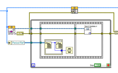

Using messages adds non trivial overhead so taking measurements at higher rates isn't practical. I use a different tact for acquiring data. I put my acquire and send code right into a helper loop on the actor core.vi diagram. My actor behaves as an asynchronous shell within which I do what might be considered "classic" state machine for acquiring data. For example, I put my DAQmx calls there, then load the data into a queue for transfer to another actor that does some processing.
I stick with actors because for launching many and configuration AF works great. I only pull out the high speed data recording into the helper loops but leave everything else messages.

Thanks wrkcrw00, I will try to create helper loop.
In your code, how the helper loop communicate with Parent Actor.vi?
I want to know better case to do the communication.
