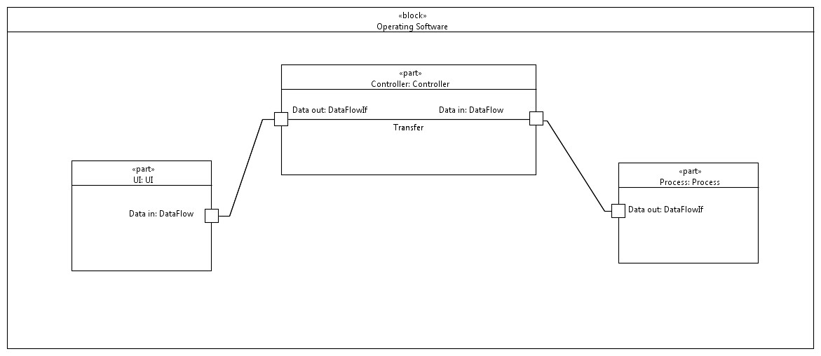

I use SysML instead of UML, because it has some features that fit the actor framework better that the UML.
It has the notion of a block, that can be stereotyped to anything. I have a stereotype for Actor.
I use the:
1. Block Definition Diagram (BDD): for actor hierarchy description that reflects the callee - caller actor (I actually use my own modified actor called extor) relations
2. Class diagram: as in UML, to show class hierarchy, data, methods...
3. Internal Block Diagram (IBD): it can include all the nested actors of a caller actor. I use this diagram to indicate the receive/send messages and data flow. I use the interface stereotype to define the datatype my messages use, and put ports on the edge of the parts in my IBD to indicate messages. I connect the ports that I actually connect in the program (a receive - send message pair)
4. The ports on these parts are of the interface type defined in the BDD I use for interface definition:
5. I use activity diagram to indicate how the actors operate, how do the different states depend on each other, how to init, deinit, etc.
6. Sequence diagrams could also be nice and useful, however the activity diagram fits my view of actors better (as actors are asynchronous, if no intentional synchronization is built in into a system)
(note: When I write "send message" I mean the abstract parent message of a "zero coupled message construct")
And the program I use is the Eclipse. It has the Papyrus module, that handles SysML diagrams.
To be exact I use the Polarsys version of Eclipse, it has all I need for SysML.
