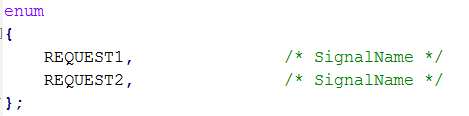

I need it find all signals of dbc file and write them "enum" form and "Struct" form.
