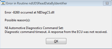

1- When I run the examples without changing them, I got this error :
2- I can't use Bus Monitor, because Labwindows says that the LIN ressource is used, so I'm using MuxTrace in spy mode to see the LIN frames, and it works.

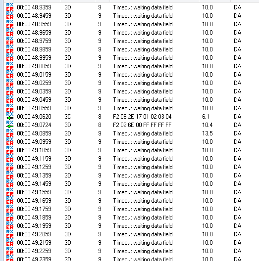

The only unpleasant thing that I have not understood is that my software send contineousely 0x3D resquest frames (see pic) and I don't know how to stop that.
I already set up a timer (every 3 seconds) where I send a frame to keep LIN communication. But the thing is that between these frames, I have a resquest frame every 10ms ........
