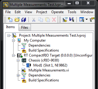

We switched now to NI 9862 instead of NI 9853. Is it possible to run the 'Multiple Measurement' example with 9862? If yes, how?

For the cRIO-906x and cRIO-903x families it is pretty straightforward. Simply save the Multiple Measurements example as a copy somewhere. Next create a blank LabVIEW project, add the cRIO target, and then add the Multiple Measurements example as a VI under the RT target. Add the 9862 c-Series module and it should work.
Of course this assumes that you have formatted the target and installed EUCMC. The A2L file for the Multiple Measurements example will insall on the cRIO by default. I typically hard-code the A2L reference like so:
If you want to try a different A2L file, the A2L file will need to be FTP'd over to the cRIO.
If you are using a different model cRIO, the steps are mostly the same, however, you will have to compile a blank bitfile for the FPGA and start it before the 986x module can be recognized. This is a limitation of XNET and more information can be found on page 2-7 of the XNET manual.

Both XCP and CCP examples are working with NI 9862: CCP/XCP Test ECU on 9068 and Multiple Measurement example on 9035. However, I could not see 9862 CAN interfaces on both cRIOs until I compiled and run an empty FPGA.
