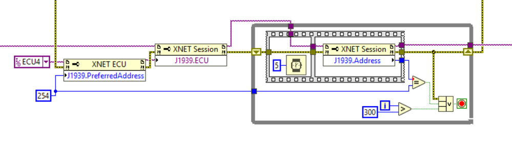

The address claim procedure occurs when the J1939 Address property or J1939 ECU property is written to so long as the write occurs after the interface has been started. In our case, we want ECU 1,2, and 3 to properly claim and retain their respective addresses while leaving the input session with a null address to read. While working around the bug(s) isn't pretty, I think I have found a way to achieve this. I override the preferred address of ECU4 in with a property node to 254 and serialized the Start Simulation VI to set the ECU for the input sessions after the interface is started and before the output sessions have their ECUs set. Probing the addresses just before Start Simulation exits shows all nodes having the proper address with the input session having 254. My testing also showed that the output nodes responded appropriately to node contentions even though these shouldn't occur in your setup.
We went over the issue with the developers in great detail this morning. They also performed some experiments in trying to isolate the bug. They found that setting the ECU seemed to work properly when it is done prior to starting the session. They modified the Initialization VI to set all ECUs right after session creation but noted that it still breaks if the ECUs are set again in Start Simulation.vi. I will try to send you the modified files through the SR.
