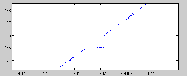

As for the samples, I created a test environment: A microcontroller sends a signal via CAN. The signal contains a value that is incremented by 1 with each new CAN message. My PXI measurement programm samples these CAN signal values alongside with DAQmx (5 KHz sample rate, reading 1000 CAN and DAQmx AI values in a while loop). The plot below shows, that sometimes the current value is not sampled, instead the last value is resampled up to 16 times, i. e. the value does stay the same as the last value where it should increment. I made sure, that the source of this effect is not the microcontroller using a third party CAN logging tool.

Does anyone know why I get these repeated CAN signal values?
