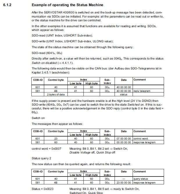

I wished to perform a "SDO-READ" and "SDO-WRITE" using the Frame API as followed :
http://img.photobucket.com/albums/v208/rainman1978/sdoexample.jpg
The Frame API VB software example given has this abiturary ID, data length, remote frame (YES/NO) and extended frame (YES/NO). In the write procedure it has :

I made change to the transmit datas.
Transmit.Data(0)=&H40
Transmit.Data(1)=&H41
Transmit.Data(2)=&H60
Transmit.Data(3)=&H0
Transmit.Data(4)=&H40
Transmit.Data(5)=&H0
Transmit.Data(6)=&H0
Transmit.Data(7)=&H0
There isn't any response back from  the amplifier and I bet the frame format must be wrong.

Managed to get it worked.
Using the COB-ID is crucial!

Got it!!!
To all that will try to use the VB6 application:
In the LabView examples the COB ID default is in hex, and in the VB examples the COB ID default is dec !!! The GUI of the 2 examples (VB & LabView) is exactly the same but it will not work unless you use the correct COB-ID.
So, for example, if you want to use the labview example and you want to enter the ID 601: you Enter 601 in the ID text box.
However, if you want to use the VB6 example with the same ID you need to insert 1537 (=601 hex!!)
I hope that with this post I will save some people the 3 days that it took me to find this!
