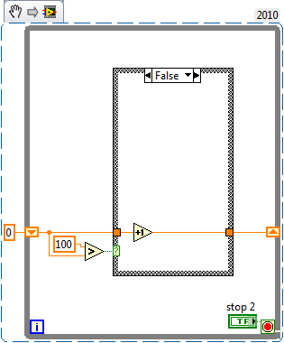

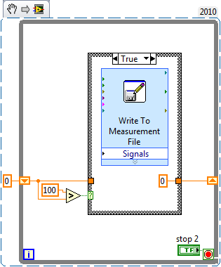

I'm sorry I missed your code in the last post.  I have taken a look and this is the preferred method limiting the CPU usage of a while loop.  However, in your case, it seems that this is causing a problem with the read.  Have you tried using Highlight Execution () to see how the data flow is going?  Does the problem happen with all values of wait (longer than 400 ms, or shorter than 100 ms)? For example, the 5 ms wait in the Default case of the case structure.  Does this cause the same problem?
If you are worried about the size of logfiles, you can always decimate the data in some other way.  One way would be to store the data in an array, then use the Decimate 1D Array.  Another would be to put the log function, and only record every 3rd, 5th, 100th, etc data point as below
I would try to avoid having a while loop with no wait at all in it, as this will eat up a lot of your processor time, but if no other way can be found with this third party dll, the options above may provide some alternatives.
