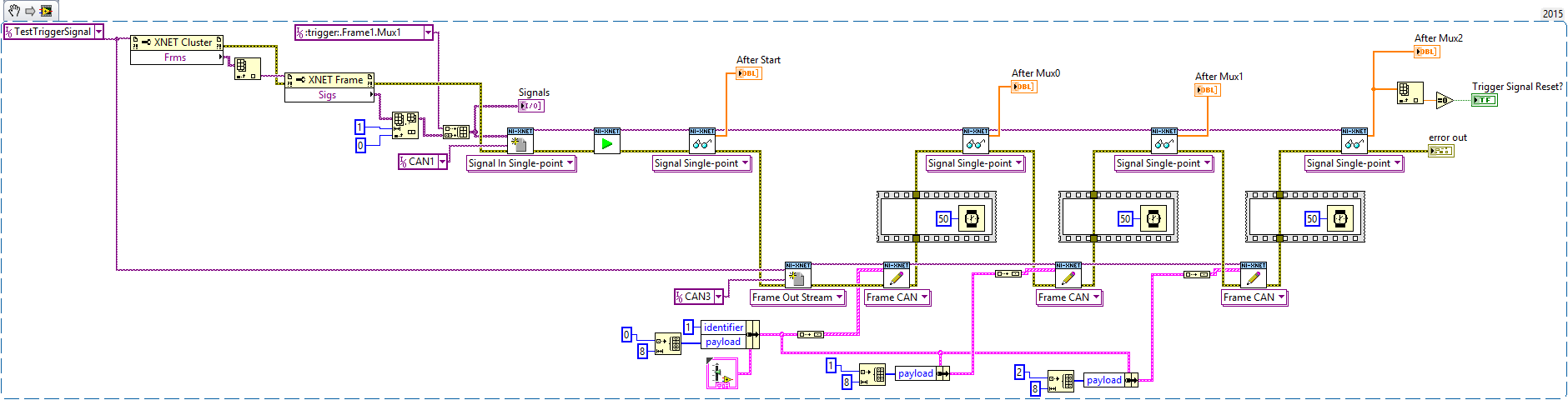

I made a quick test case and it looks like the trigger signal isn't resetting to zero after a new frame is received. Is this the behavior you are seeing or is your scenario different?

It is a snippet, go to the image at this address, then drag it to a folder in windows (saving it) then drag from that location to the LabVIEW block diagram to open it.  That being said the code was also attached as a zip.
