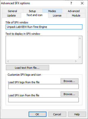

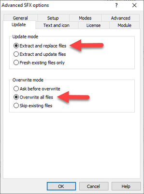

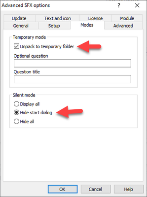

7. Configure the SFX options as shown below:
2020-02-24_10-58-36.png2020-02-24_10-59-17.png2020-02-24_10-59-52.png2020-02-24_11-00-21.png
8. Click OK and OK again to create the archive. This will create an EXE file that will extract the NI Run-Time Engine and launch the Install.exe program
