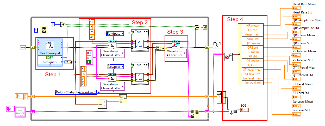

The process of ECG feature extractor includes 4 steps:
Following is a typical example for ECG feature extractor:
In step 1, Read Biosignal Express VI is used to read ECG signals from file. You can replace it with Biosignal DAQ Express VI if you want to acquire ECG signals from DAQ.
In step 2, Biosignal Filtering VIs are used to filter the ECG signal. For ECG input, use a 10-25Hz bandpass filter to make the QRS waves easier to be detected. For raw ECG input, use a lowpass filter to remove the high frequency noise in the original signal, to make the feature extraction result more accurate.
The filtering causes a latency of the ECG signal, which should be eliminated in order to keep the accuracy of extracted results. This can be simply done by discarding the first N/2 points of the first block of filtered ECG signal, where N equals to the order of the filter.
In Step 3, ECG Feature Extractor VI is used. You can choose to extract all features (including the time of P, QRS, and T waves) or only QRS waves through the polymorphic selector. When you need to extract all features, you should connect both raw ECG and ECG. raw ECG can be the original signal or slightly processed using low-pass filter (the signal amplitude should not be changed a lot).
Step 4 is optional. You can visualize the extracted features like the following figure. Search “ECG Feature Extractor” in NI Example Finder for more information.
You can also analyze the statistics of extracted ECG features. Such as the mean value and standard deviation of heart rate, QRS width, etc.

Hi, thank you, can you upload the example from first picture? 🙂
Where can i find this ?
So, you are not willing to share the project?
