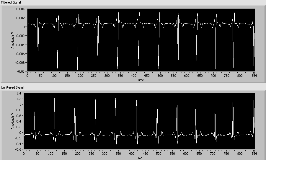

This is my first time using LabView. When I connect the file io.vi to create the tdms it drastically slowed down the program and it didn't seem to acquire the signals correctly. I also installed the OOo Calc TDMS add-on to see what data it stored, but like other users it didn't create the menu item in Calc. My input signal is very clean as I am using an arbitrary waveform generator to simulate the ECG. I took a screen shot to show that the signal is nearly identical, but it is attenuated and it is inverted. What could be causing this?
