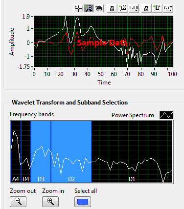

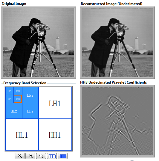

In Advanced Signal Processing Toolkit, we have some express VIs to help customers to display subbands:
1D:
2D:

For 2D wavelet, the output is contains different level's coeffients. Each level's approximation and detailed coefficients represent different subbands.
