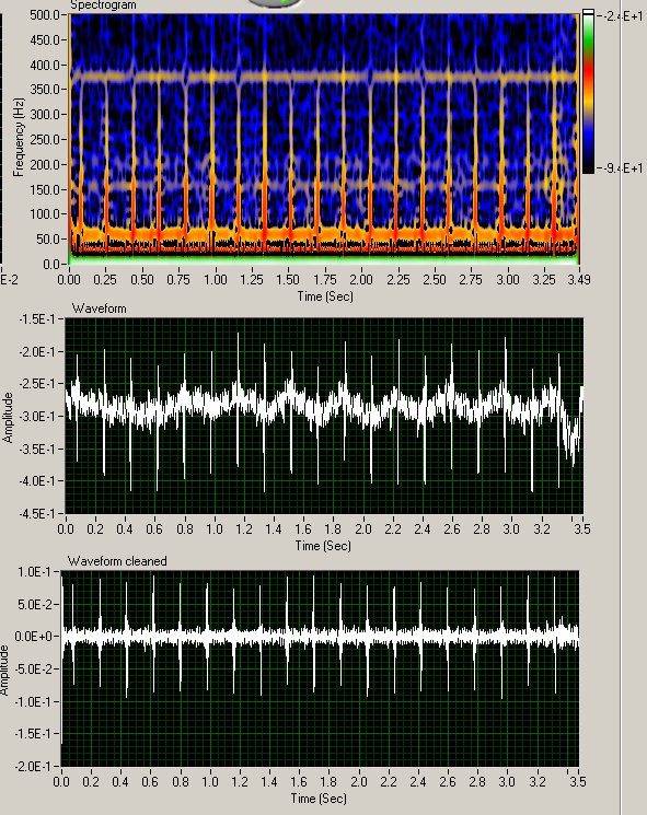

Hi
I did some joint time frequency analysis on your signal. And from what I can see, you do not any fancy tools to clean up your signal. A low order high pass filter will do the work. You could perhaps implement as an analog filter. If we look at the signal analysis we see that each heart beat produces quite high frequencies. but around the mains frequency (60 Hz in your case I guess) and below we have a constant noise carpet. In your case I would experiment with a high pass filter with a cutoff somewhat above the mains frequency. You can use analog or digital. And perhaps increase the sample frequency, say 2 to 5 KHz. If you use proper storing format (not .lvm ) and store your numbers as SGL (4 bytes). The disk cost will be around 70Mb per hour(5 KHz). Not to much in our days.
As I can see your project will require some programming but if you have a more advanced Labview version than the Labview Base. All functions should be included. I also believe the source code for the Biomedical Startup Kit is available so you can use this for inspiration. But if some toolkit are required and the it is to much for your budget. You will be able to create a HRV spectrogram by using standard peak detection and a function named "Unevenly Sampled Signal Spectrum.vi" If you go to help in the toolbar and Find Examples. You can search for Unevenly. Locate the "Generalized Fourier Spectrum.vi" and use this as an example
You may also perhaps gain something by using a more advanced frontend. In the link below you will find a circuit that incorporate many interesting design elements. You can use it as a reference design and modify it as it is made for human ECG. A3 as an example is used simple low pass filter with a corner frequency around 100Hz. And that will not fit  your application at all. I would have replaced it with a 2. order high pass filter. The circuit use somewhat exotic ICs, but you do not have to use the exact same circuits. But some high quality opamps are needed (not 741 or lm324 ) It is also designed for a signle ended supply voltage. But as I understand you are a technical student so will be able to modify as needed.
