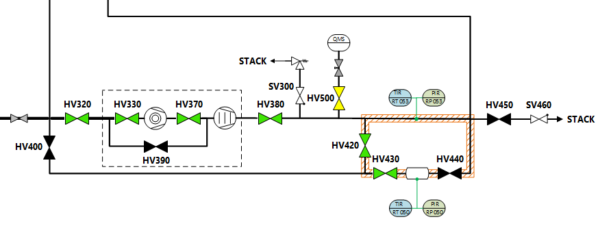

Recently we build up like 1-2 new experimental rig per year. The base of my GUIs always come from a piping and instrumentation diagram (P&ID) which I use as a background on my FP. I create the active parts as needed for the UI, like custom picture rings (3 states) for the hand valves, other symbols for Mass flow controllers, pressure/temperature sensors, vacuum pumps, etc. See below a small example screenshot (a small cut out of a large GUI), plus custom controls for white background GUI.
Everything is ok, and I develop these systems without any problem (I know there is the DSC toolkit for such applications, but we do not need "that much" industrial level/approach). However, recently I started to think about how cool it would be to use not only a large monitor as now, but one with a touchscreen connected to the system PC (laptop or desktop with Win7 OS). Actually there is not only the cool factor, but easy usage: for example during an experimental protocol the operator(s) need to change hand valve positions very frequently. The operator moves along the experimental rig (large physical dimensions) and between the PC keyboard+mouse, so it is not that comfortable if the table is small, you need to find the mouse, after you try to find the mouse pointer on the large screen, your wrist hurts after a while because of the mouse if you do all this standing, etc... πŸ™‚
