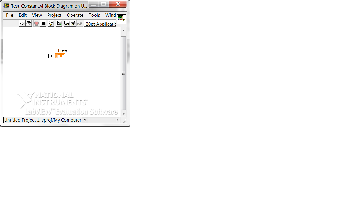

Isn't this kind of easy to do with LVOOP?
A write function which allows only a single execution, otherwise returning an error?
Shane
Message 42 of 89
(12,244 Views)
Shane
I don't remeber which thread I posted this image too but YES!
Ben
