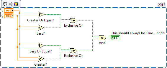

In the snippet below, the final output Boolean always evaluates to TRUE ... right?
Not quite!
The two pairs of functions are not exactly inverses of the other for IEEE 754 Floating Points, meaning the XOR of the two functions is not always TRUE. As with the first Bit of Minutiae, this discontinuity happens when either input is NaN.
The semantics of this output are very important to consider when designing fail-safe systems. Ensure that you choose the correct function with the desirable result, which is oftentimes a failure mode, for NaN!
