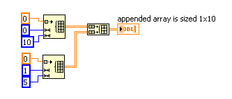

Another one: Empty arrays (>=2D) have "ghost" non-empty dimensions that affects operations with other arrays:
On concatenation, the appended array takes the largest number of columns, which is 10 even if the first aray is empty.
It may be handy when initializing an empty array that must have a minimum column width.

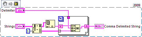

Here's a snippet of the delimiter I use instead:
18655i52A60AA8BE4A669F
(Homework: this VI may be more efficient with an auto-indexed output run into a final Concatenate....)

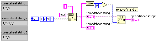

I like to use Array to Spreadsheet String because it is simple.  I just remove the last two characters (\r, \n) at the end.
18657i14BF9416EDE85332
Note: NOT robust for porting OS's (are you supposed to remove one byte? two bytes?). I have seen a different flavor that actually removes the number of characters returned by the "End Of Line Character" on the string palette, but at this point the code gets dirtier and more obfuscated than the roll-your-own delimiter.
Plus, the roll-your-own version can easily support a Unicode UTF-16 string, whereas the "Array to Spreadsheet String" is stuck in the ASCII realm.
I use the Trim Whitespace on the output.
I just use the Trim Whitespace.vi found in the string pallet to remove the EOL.

I never have to port to another OS nor do I ever have to use UNICODE.  So I typically don't think about those things.  But the trim whitespace solution would be the best if you have to worry about those things.
