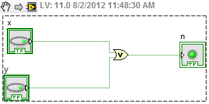

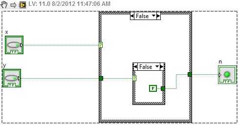

Same can be easily represented as:
Thanks as kudos only:)
