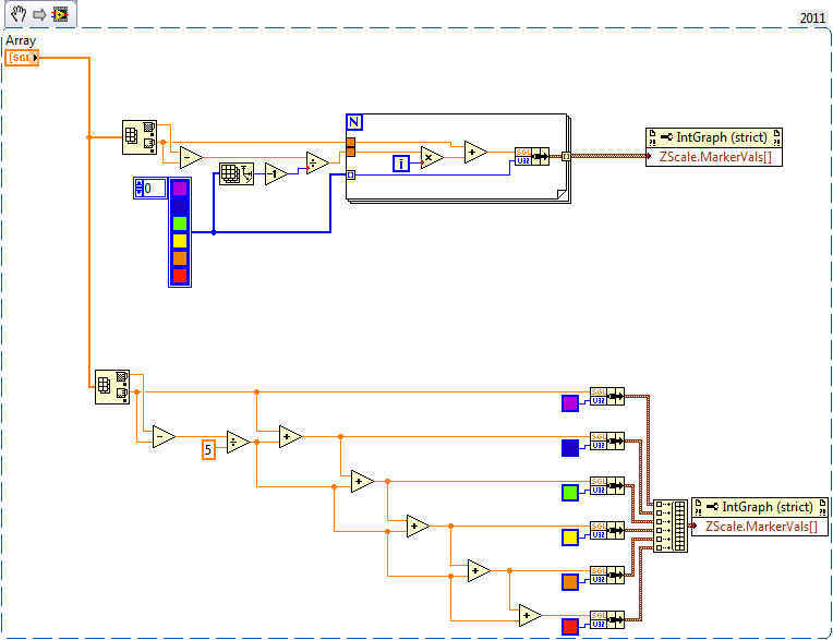

Here's another small one:
The lower one simply isn't scalable. The picture shows the algorithm after cleaning it up.
Here's what I would do... 😄

Well, that's part of why I posted it here... Nice one!
At least now I know what the thing I get from quickdrop when wanting "index array" does...
Edit: Also, mine doesn't work for a single color. Then again, why would anyone need it to?

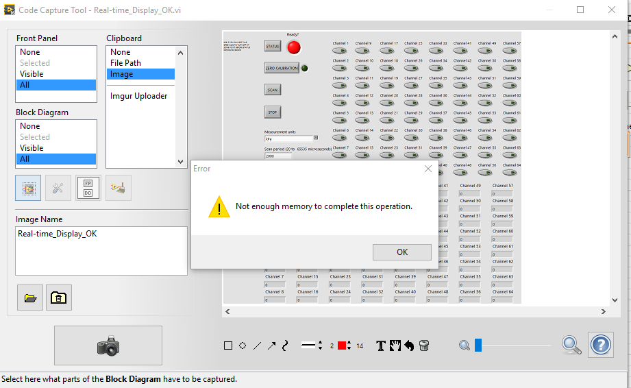

Note to self:
Do not ever crash the CCT!
After crashing and attempting to close LabVIEW the darn thing was still running.
After BLOWING LabVIEW away via Task Manager and re-opening LabVIEW I created a new Blank lvproj.

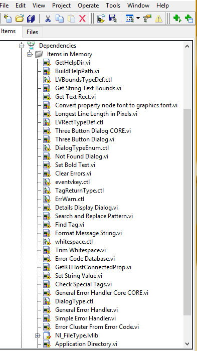

Doesn't that look a lot like the CCT Dependancies list?
I'll be back after a reboot I guess.
Nope, or if it is, it is an extremely partial list, because the CCT has a bunch of VIs of its own and your scrollbar shows there isn't enough space there for those (not to mention that your dependencies list is a bit weird in that it doesn't show those VIs under the vi.lib folder, which it usually should. I think you might be seeing separate utility copies which LV might be using for itself?).
But yeah, the CCT was never optimized for large BDs. I tried quite a few years back and gave up when I saw the level of effort compared to the potential result (let's just say the NI picture control was not designed for effiency with raster images).
