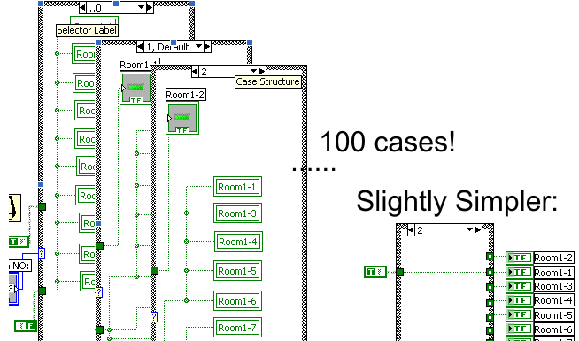

OK, here's another typical case that shows up once in a while. In this example, we need to turn on one (exactly one) of 100 LEDs depending on some number.
We could just initialize a 2D array of FALSE booleans once outside the loop and replace a single element with TRUE using code the size of a postage stamp. Then display the 2D array directly, possibly with a label overlay. 🙂
...or we could spend days, if not weeks, creating a case structure with 100 cases, each containing "a boolean and 99 local variables" (Isn't there a song about this 🐵 .
(For a small number of individual booleans, the code suggestion shown on the right would be reasonable too.)

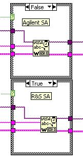

Here is one I caught this morning of my own doing...
How did this happen?  Simple...  It started out that the Case Statement contained a a full (sub) vi.
From the beginning...  A Case Statement was created to select one of two Spectrum Analyzers to do a "quick" measurement.  Since equipment is shared, one of the two may appear as part of the setup.  Later, programmed evolved and the Case Statement moved elsewhere (and duplicated).  At some point, the instrument initialization routine was taken out of the sub-vi's within this particular Case Statement.
Lo & Behold..  After another mod, the sub-vi then became a simple VISA Write function (that was part of the evolution.  And ther was No need to have a vi for that.).  Then the same was done (at a later date) for the other SA. Most likely noticed after a switch, where the VI was no longer "suitable".  So then, both cases became a simple VISA Write... Which is what you see in the picture..  Of course the code was done in a hurry, with little thinking and even less coffee!!!  😮

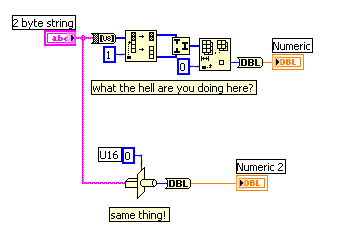

The challenge is to cast a two-byte string into an integer.
Let's see, that's easy!
  1. Convert the string to a byte array with two elements
  2. split the array at position 1 creating two U8 arrays with one element each.
  3. Join the two arrays, creating an U16 array with one element
  4. Use "delete from array" (!!!), ignore the "array with subset deleted" output, and tap into the "deleted portion" to get the first element in the array.
  5. Tap head and rub belly at the same time
  6. ...

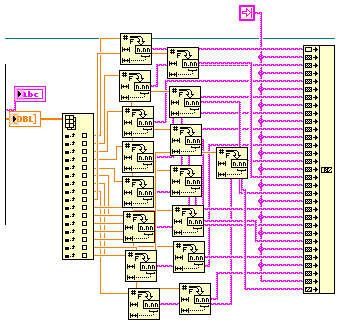

And here's another one:
into:
Ton
PS:
and even the tab and %.3f constant are optional...

I'm happy that the array wasn't much bigger (or we would  have probably needed to order another spool of LabVIEW wire from NI). 😮
The code is actually not that bad. I've seen similar but with many individual, explicitely wired "index array" nodes on the left. One for each element.
(btw: the format string is a required input for spreadsheet string to array, at least in all versions I ever used. However, the enforcement is quite lax: You can wire an empty string as format and the broken run arrow disappears immediately. Run it and the result looks just fine. :))
