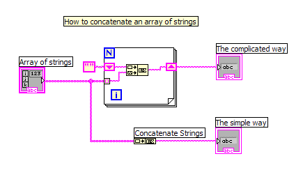

There are many ways to concatenate the elements of a string array.
  1. Some involve FOR loops, an initialized shift register and other trimmings.
  2. Some just use a simple atomic operation. 🙂
Message Edited by altenbach on 09-21-2007 11:27 AM
