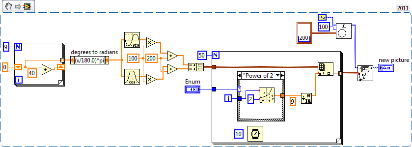

1. This is a simple graphics puzzle.  Using LabVIEW draw a circle and create nine points along the circle, equidistance around the circumference.
We will call the points "1" - "9" on it excluding "0".
Now start with the number 1 and double it, you get 2, draw a line from 1 to 2.
Now take 2 and double it, you get 4, draw a line from 2 to 4
Now take 4 and double it, you get 8, draw a line from 4 to 8
8 doubled is 16, but we only have the digits 1-9 so add the digits 1 + 6 = 7.  Draw a line from 8 to 7
Continue the pattern:
32 would reduce to 3 + 2 = 5
64 would reduce to 6 + 4 = 10, which would reduce further to 1 + 0 = 1, and so on always summing the digit to get an integer between 1 and 9.
Continue this pattern and see what happens.  1, 2, 4, 8, 16, 32, 64...
2.  Now try multiplying by 5s.  1, 5, 10, 15...
3.  Next, try counting by odd integers.  1, 3, 5...
The first person with all three pictures using LabVIEW graphics functions is the winner...

There you go:

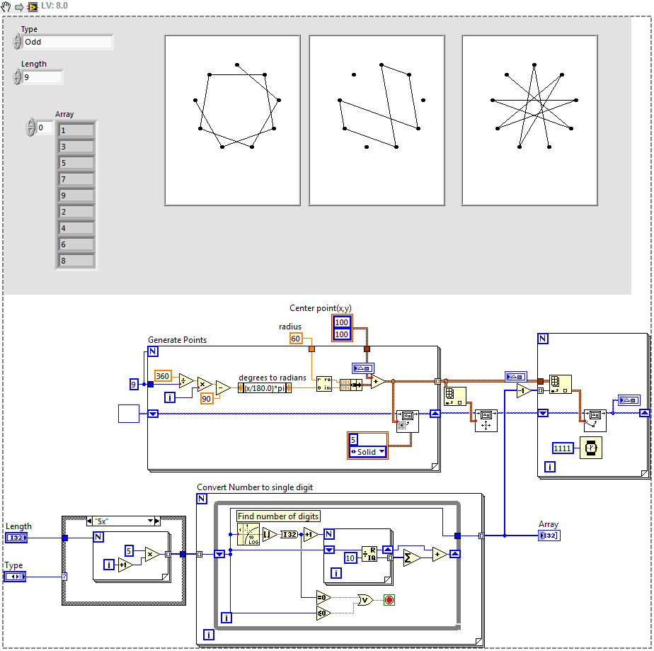

Very nice solution.  I hope you enjoyed it as much as I did.
 It's always fun seeing other peoples solutions.  Here is mine.
-SS
Circle of 9.png.

Well, at least I learned from your solution that the sum of the digits of a number is equal to N MOD 9 (if you're willing to get 0 instead of 9). I didn't know that.

Not the most straight forward explanation here but the link will probabaly out live most the math sites:
http://en.m.wikipedia.org/wiki/Casting_out_nines

I prefer the regular (non-mobile) site: Casting_out_nines
