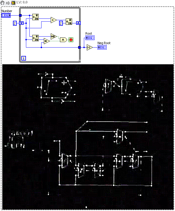

Well, unlike LV, he seemed to have a zoom feature 😉 .
As near as I can tell, this is the method he used in the code (yes, I know that it doesn't play well with non-squares, but he did say he used only square integers and I didn't feel like finding a better stop condition):
You can find a basic description of the algorithm at the top of this page - http://mathforum.org/dr.math/faq/faq.sqrt.by.hand.html
Also, sorry about the quality of the image, but I didn't feel like working out how to get several frames and play with them so that their white parts would accumulate and then we could see it nicely.
