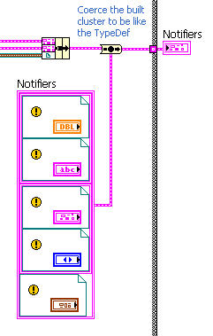

I learned that the new undocumented Coerce to Type indeed should be supported, and I learned a good use for it as shown. I built a cluster and typed the wire to my Type Def, which you might otherwise do with a TypeCast...
... see Jack's idea and follow some discussions..
http://forums.ni.com/t5/LabVIEW-Idea-Exchange/Officially-Support-quot-Coerce-to-Type-quot/idi-p/1213...

JackDunaway wrote:
Thanks for the plug! I've got to ask... why not go simpler:
My quick edit to my code in order to post a screenshot ended up missing a wire which would have gotten across the point that I typed dissimilar sub-cluster names.
In both your snippet and mine, the output wire will assume the names of the cluster constant (regardless of the names of the wires coming into the Bundle), so I still hold the Coerce to Type is unnecessary.
I meant like this.... Is there another obvious way to do this??...

An added benefit of the method below is it shows explicitly that "Apples" is being wired into "Coffee".
