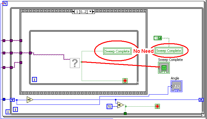

Someone is afraid of wiring directly...  This is probably more a Goldberg.
Actually, why is it needed if the value is almost immediately reset (it the sweep was complete)?   The only thing between setting the sweep complete value and resetting it is writing to a spreadsheet which should be relatively quick..
Maybe a bad example all together of Local abuse...  I just don't see why sweep complete is needed at all..  😮
from: http://forums.ni.com/ni/board/message?board.id=170&thread.id=336680
Message Edited by JoeLabView on 07-01-2008 02:33 PM
